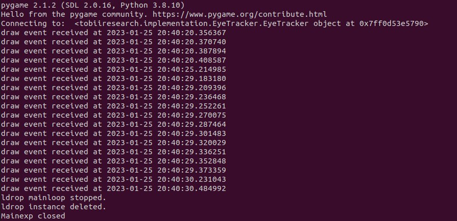

Вот скриншот, когда я печатаю время события рисования:я печатаю текущее время каждый раз <code>on_draw</code>вызывается и вручную запускает программу, несколько раз переключает окна и закрывает программу.:wq
То же в тексте:
      pygame 2.1.2 (SDL 2.0.16, Python 3.8.10)
Hello from the pygame community. https://www.pygame.org/contribute.html
Connecting to:  <tobiiresearch.implementation.EyeTracker.EyeTracker object at 0x7ff0d53e5790>
draw event received at 2023-01-25 20:40:20.356367
draw event received at 2023-01-25 20:40:20.370740
draw event received at 2023-01-25 20:40:20.387894
draw event received at 2023-01-25 20:40:20.408587
draw event received at 2023-01-25 20:40:25.214985
draw event received at 2023-01-25 20:40:29.183180
draw event received at 2023-01-25 20:40:29.209396
draw event received at 2023-01-25 20:40:29.236468
draw event received at 2023-01-25 20:40:29.252261
draw event received at 2023-01-25 20:40:29.270075
draw event received at 2023-01-25 20:40:29.287464
draw event received at 2023-01-25 20:40:29.301483
draw event received at 2023-01-25 20:40:29.320029
draw event received at 2023-01-25 20:40:29.336251
draw event received at 2023-01-25 20:40:29.352848
draw event received at 2023-01-25 20:40:29.373359
draw event received at 2023-01-25 20:40:30.231043
draw event received at 2023-01-25 20:40:30.484992
ldrop mainloop stopped.
ldrop instance deleted.
