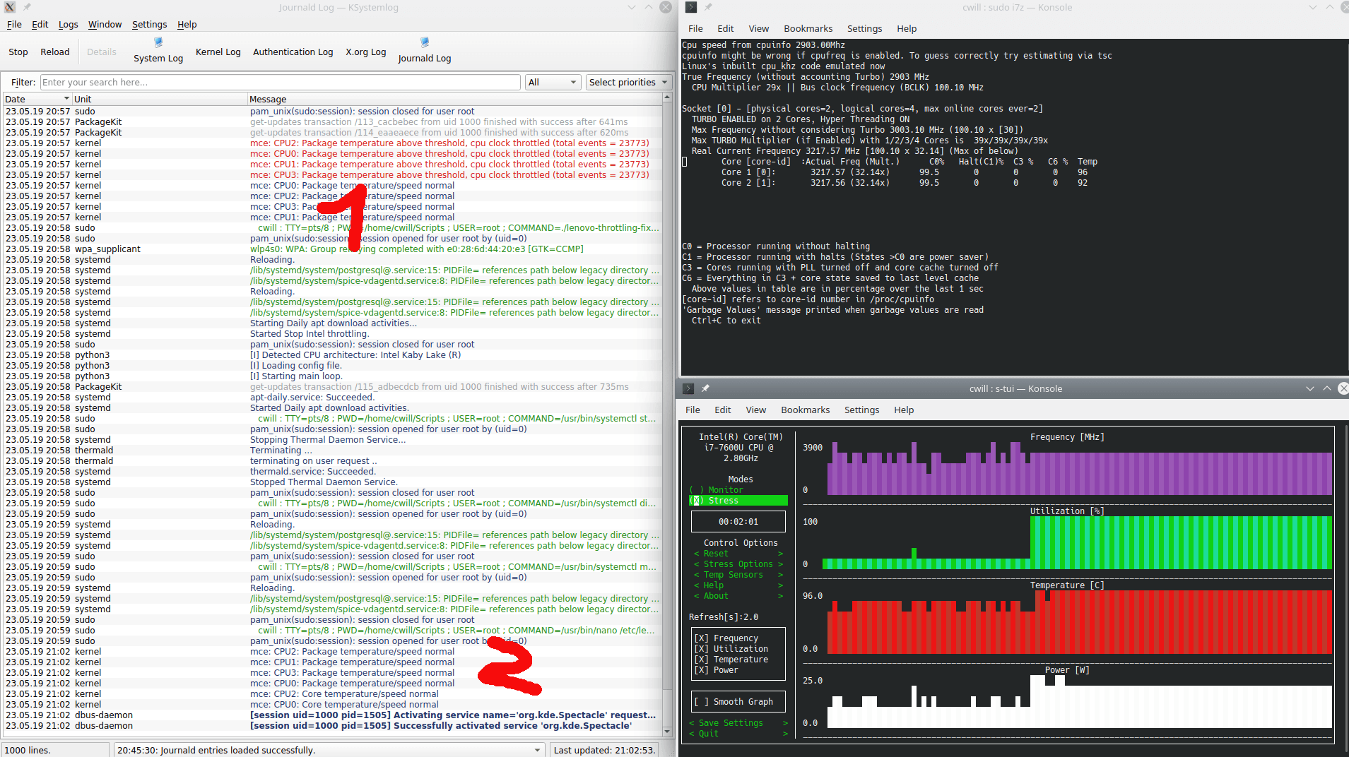

Я получаю следующие сообщения об ошибках пару раз в час:
08.03.18 21:27  kernel  CPU0: Core temperature above threshold, cpu clock throttled (total events = 2234)
08.03.18 21:27  kernel  CPU2: Core temperature above threshold, cpu clock throttled (total events = 2234)
08.03.18 21:27  kernel  CPU1: Package temperature above threshold, cpu clock throttled (total events = 2695)
08.03.18 21:27  kernel  CPU3: Package temperature above threshold, cpu clock throttled (total events = 2695)
08.03.18 21:27  kernel  CPU2: Package temperature above threshold, cpu clock throttled (total events = 2695)
08.03.18 21:27  kernel  CPU0: Package temperature above threshold, cpu clock throttled (total events = 2695)
08.03.18 21:27  kernel  CPU2: Core temperature/speed normal
08.03.18 21:27  kernel  CPU0: Core temperature/speed normal
08.03.18 21:27  kernel  CPU3: Package temperature/speed normal
08.03.18 21:27  kernel  CPU1: Package temperature/speed normal
08.03.18 21:27  kernel  CPU0: Package temperature/speed normal
08.03.18 21:27  kernel  CPU2: Package temperature/speed normal

Статистика
Когда я запускаю стресс-тест
stress -c 4 -t 300
сообщение об ошибке происходит практически мгновенно.
i7z выдает следующий вывод:
Cpu speed from cpuinfo 2903.00Mhz
cpuinfo might be wrong if cpufreq is enabled. To guess correctly try estimating via tsc
Linux's inbuilt cpu_khz code emulated now
True Frequency (without accounting Turbo) 2903 MHz
  CPU Multiplier 29x || Bus clock frequency (BCLK) 100.10 MHz
Socket [0] - [physical cores=2, logical cores=4, max online cores ever=2]
  TURBO ENABLED on 2 Cores, Hyper Threading ON
  Max Frequency without considering Turbo 3003.10 MHz (100.10 x [30])
  Max TURBO Multiplier (if Enabled) with 1/2/3/4 Cores is  39x/39x/39x/39x
  Real Current Frequency 3187.97 MHz [100.10 x 31.85] (Max of below)
        Core [core-id]  :Actual Freq (Mult.)      C0%   Halt(C1)%  C3 %   C6 %  Temp      VCore
        Core 1 [0]:       3187.97 (31.85x)      99.9       0       0       0    85      1.0037
        Core 2 [1]:       3187.97 (31.85x)      99.9       0       0       0    84      1.0037
C0 = Processor running without halting
C1 = Processor running with halts (States >C0 are power saver modes with cores idling)
C3 = Cores running with PLL turned off and core cache turned off
C6, C7 = Everything in C3 + core state saved to last level cache, C7 is deeper than C6
  Above values in table are in percentage over the last 1 sec
[core-id] refers to core-id number in /proc/cpuinfo
'Garbage Values' message printed when garbage values are read
  Ctrl+C to exit
Как уже говорилось, он никогда не превышает 85 Temp, но процессор замедляется.

Это не имеет никакого значения, но я могу видеть настройки порогов как минимум (последние строки):
╰─ sudo thermald --no-daemon --loglevel=info
NO RAPL sysfs present
22 CPUID levels; family:model:stepping 0x6:8e:9 (6:142:9)
Running on a vanilla kernel
Polling mode is enabled: 4
sensor_update: type x86_pkg_temp
sensor_update: type pch_skylake
sensor_update: type iwlwifi
sensor_update: type acpitz
thd_read_default_thermal_sensors loaded 4 sensors
dts /sys/devices/platform/coretemp.0/name doesn't exist
dts /sys/class/hwmon/hwmon3/name doesn't exist
failed to open /dev/acpi_thermal_rel
TRT/ART read failed
 Dumping parsed XML Data
 *** Index 0 ***
UUID:
type: 0
        Zone 0
                 Trip Point 0
                  temp 90000
                  trip type 2
                  hyst id 0
                  sensor type x86_pkg_temp
                  cdev index 0
                          type _fan_
                          influence 0
                          SamplingPeriod 0
        Cooling Dev 0
                Type: _fan_
                Path: /sys/bus/platform/devices/thinkpad_hwmon/pwm1
                Min: 100
                Max: 255
                Step: 50
                AutoDownControl: 0
Product Name matched [wildcard]
sensor index:3 x86_pkg_temp /sys/class/thermal/thermal_zone3/ Async:1
sensor index:1 pch_skylake /sys/class/thermal/thermal_zone1/ Async:0
sensor index:2 iwlwifi /sys/class/thermal/thermal_zone2/ Async:0
sensor index:0 acpitz /sys/class/thermal/thermal_zone0/ Async:0
sensor index:4 hwmon /sys/class/hwmon/hwmon1/temp1_input Async:0
sensor index:5 hwmon /sys/class/hwmon/hwmon1/temp2_input Async:0
sensor index:6 hwmon /sys/class/hwmon/hwmon1/temp3_input Async:0
thd_read_default_cooling devices loaded 4 cdevs
powercap RAPL no long term time window
Use Default pstate drv settings
3: Processor, C:0 MN: 0 MX:10 ST:1 pt:/sys/class/thermal/ rd_bk 0
1: Processor, C:0 MN: 0 MX:10 ST:1 pt:/sys/class/thermal/ rd_bk 0
2: Processor, C:0 MN: 0 MX:10 ST:1 pt:/sys/class/thermal/ rd_bk 0
0: Processor, C:0 MN: 0 MX:10 ST:1 pt:/sys/class/thermal/ rd_bk 0
4: intel_pstate, C:0 MN: 0 MX:10 ST:1 pt:/sys/devices/system/cpu/intel_pstate/ rd_bk 1
5: _fan_, C:255 MN: 100 MX:255 ST:50 pt:/sys/bus/platform/devices/thinkpad_hwmon/pwm1 rd_bk 1
6: LCD, C:0 MN: 0 MX:1060 ST:106 pt:/sys/class/backlight/intel_backlight/ rd_bk 1
Sorted trip dump zone index:1 type:pch_skylake:
index 0: type:critical temp:115000 hyst:1 zone id:1 sensor id:1 cdev size:0
trip type: 0 temp: 115000
Sorted trip dump zone index:0 type:acpitz:
index 0: type:critical temp:98000 hyst:1 zone id:0 sensor id:0 cdev size:0
trip type: 0 temp: 98000
thd_read_default_thermal_zones loaded 2 zones
zone cpu will be created
dts zone /sys/devices/platform/coretemp.0/name doesn't exist
/sys/class/hwmon/hwmon4/name->iwlwifi
/sys/class/hwmon/hwmon2/name->pch_skylake
/sys/class/hwmon/hwmon0/name->acpitz
dts zone /sys/class/hwmon/hwmon3/name doesn't exist
/sys/class/hwmon/hwmon1/name->coretemp
Buggy max temp: to close to critical 90000
Core temp DTS :critical 100000, max 90000, psv 95000
node type: Element, name: CoolingDevice value: rapl_controller
node type: Element, name: CoolingDevice value: intel_pstate
node type: Element, name: CoolingDevice value: intel_powerclamp
node type: Element, name: CoolingDevice value: cpufreq
node type: Element, name: CoolingDevice value: Processor
CDEVS order specified in thermal-cpu-cdev-order.xml
Sorted trip dump zone index:4 type:cpu:
index 0: type:passive temp:95000 hyst:0 zone id:4 sensor id:65535 cdev size:2
cdev[0] intel_pstate
cdev[1] Processor
trip type: 2 temp: 95000
zone x86_pkg_temp bounded
Sorted trip dump zone index:5 type:x86_pkg_temp:
index 0: type:passive temp:90000 hyst:0 zone id:5 sensor id:3 cdev size:1
cdev[0] _fan_
trip type: 2 temp: 90000
Zone 1: pch_skylake, Active:0 Bind:0 Sensor_cnt:1
..sensors..
..trips..
Zone 0: acpitz, Active:0 Bind:0 Sensor_cnt:1
..sensors..
..trips..
Zone 4: cpu, Active:1 Bind:0 Sensor_cnt:1
..sensors..
..trips..
cdev[1] Processor
index 1: type:polling temp:90000 hyst:0 zone id:4 sensor id:3 cdev size:0
Zone 5: x86_pkg_temp, Active:1 Bind:1 Sensor_cnt:1
..sensors..
..trips..
cdev[0] _fan_
index 1: type:polling temp:85000 hyst:0 zone id:5 sensor id:3 cdev size:0
FD = 7
Current user preference is 0
thd_engine_thread begin
Set : threshold:90000, temperature:53000, cdev:5(_fan_), curr_state:205, max_state:255
Set : threshold:90000, temperature:57000, cdev:5(_fan_), curr_state:155, max_state:255
Set : threshold:90000, temperature:85000, cdev:5(_fan_), curr_state:105, max_state:255
Set : threshold:90000, temperature:85000, cdev:5(_fan_), curr_state:100, max_state:255

@WinEunuuchs2Unix
Я создал ответ, чтобы обсудить ваш предложенный дроссельный инструмент от erpalma.
Я немного поигрался с этим инструментом - включая несколько зависаний системы:) К сожалению, я пока не смог найти подходящую конфигурацию для своей системы. Но этот инструмент определенно влияет на мою систему. В первый раз я вижу что-то действительно меняющее поведение дросселирования / температуры.
Без инструмента температура моего процессора никогда не превышала 85°C. После того, как я установил инструмент и запустил сервис, я вижу повышение температуры до 98°C под нагрузкой с частотой ядра ~3300 МГц (а не 3187 МГц).
erpalma рекомендует инструмент s-tui, который я тоже могу порекомендовать.
  1. Перед установкой упомянутой службы дроссельной заслонки
  2. После активации услуги
Я буду следить за своей системой в течение пары дней и сообщу об этом. Спасибо за сейчас!
